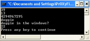

ASSIGNMENT 3.4
Question 1:
Code:
// Program StrDemo demonstrate string functions.
#include
#include
using namespace std;
const string TITLE = "How much was the doggie in the windows?";
const string CAT = "cat";
int main()
    cout<< TITLE.length() <
    cout<< TITLE.find ("the") <
    cout<< TITLE.find (CAT) <
    cout<< TITLE.substr (17, 6) <
    cout<< TITLE.substr (17, 23) <
    cout<< TITLE.substr (17, 23).length() << endl;
    return 0;
Output
